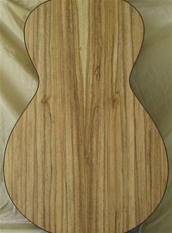

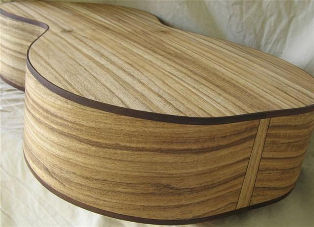

Hey Guys,
Here are a couple of in-progress pics of number three. I was really surprised how this wood changed from dull grays to nice browns with a wash coat of shellac.

Pretty combination. I like how the dark bindings contrast with the variagated striping of the back and sides.
Should come out very nice!!!
Send photos of progress

Nice wood . Is that koa? I`ve got some but I`ve never done anything with it. That wii be a nice looking instrument!
PostPosted: Wed Aug 31, 2005 12:36 pm
Almost looks like pecan??
PostPosted: Wed Aug 31, 2005 4:31 pm
Posts: 697
Is it Myrtlewood?

I especially like the end graft. Lovely job!

Bruce..very nice job. And I agree with Shane, that end graft is very tastefully done. What wood will you use for the neck ? Walnut maybe ??? Can't wait to see the finished product.

Palo Escrito?

It sure looks like Zebrano (Zebrawood) to me. And it looks great!

my guess is Palo Escrito as well.. nice job
PostPosted: Thu Sep 01, 2005 2:15 am
Nice!
Doesn't look nearly 'rich' and variegated enough for Zebrano to me, though; Zebrano I've got has more darker/golden shades and streaks running through it, even unfinished.
PostPosted: Thu Sep 01, 2005 2:40 am
im betting its PauFerro - nice job by the way!

Thanks for the compliments, guys. It's South American Laurel. It's a great wood to work with. Bends like butter and very resistant to chipping or splitting. It's light and resonant and reminds me a lot of eastern walnut.
Unfortunately, this one is going to wind up being rather plain looking. I 'm building it to be a work horse. It's mission is to be the guitar that I leave laying around the house so that I can grab it, play as the mood strikes, and not worry about beating it up. As such, I'm just going to leave the pores open and wipe it down with 5 or 6 coats of Tru-Oil. Then again, I may try french polishing it...
I'm also experimenting with an adjustable neck, so I don't want to have too much time invested if (when?) the thing folds up
Jeff - I'm going to use a Honduran mahogany neck. If it's not dark enough, maybe I'll stain it.

Very striking guitar and nice choice on the binding.
